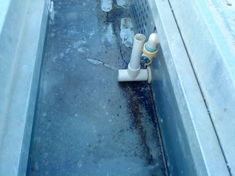

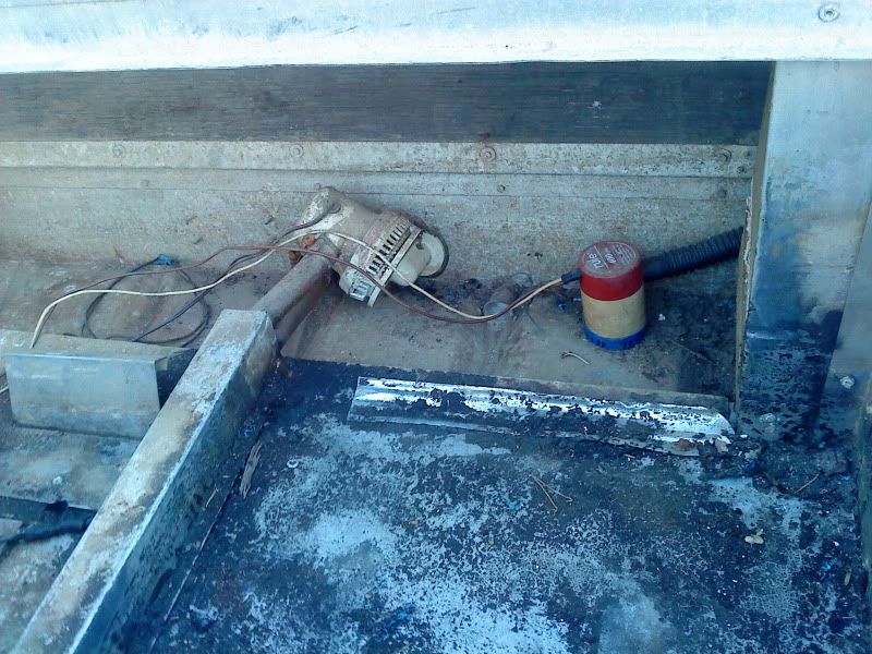

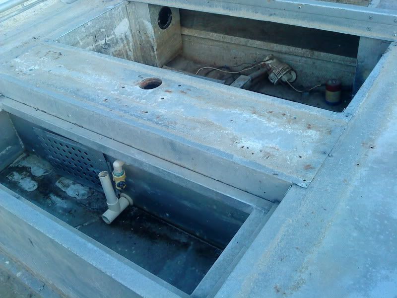

Here is the Live Well I've been asking about...
On the top you can see where the pump supplies water from the plastic fitting on the bottom of the transom.
In the bottom you can see there is a plastic "tee" that had two rubber plugs in it that drains through the bottom of
the transom just right if the inlet. Looks like the top part of the tee is a "level" for the well and the bottom is the drain. My questions how will the level tube drain while pumping fresh water (lake supplied)?
At any rate here it is.....

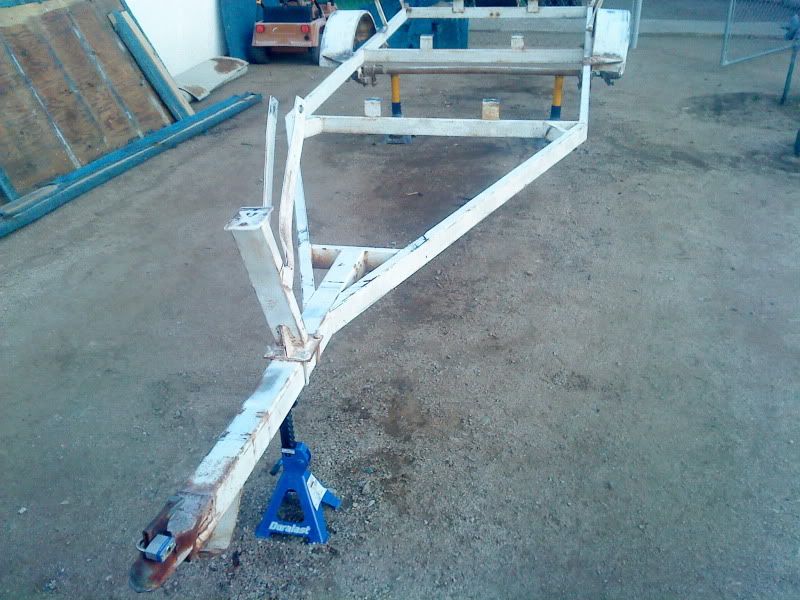

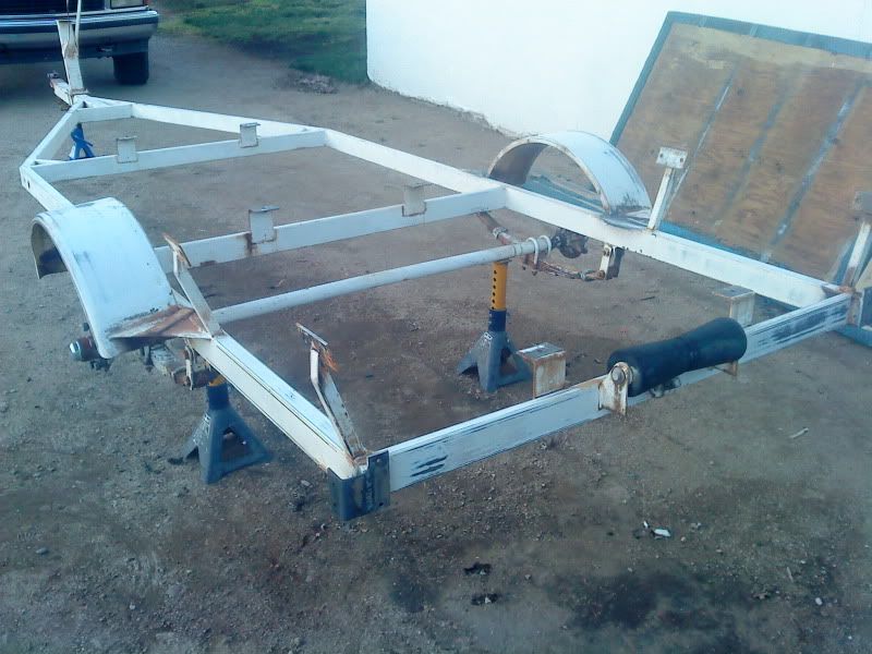

Boat is now off the trailer on stands and trailer is gutted also. Wheel bearing are toast so I'll be picking up some bearings at Napa along with some DA sanding pads and hopefully Tuesday I'll be shooting the trailer with either some Caterpillar water borne enamel or some Nason urethane. Then as soon as that is dry (thinking 24 hours to cure with the current temps) I'll get the hubs back on, wheels and wire the trailer. My order should be in soon that will include the new winch, tongue jack, bunk carpet and lights along with some bearing buddies. The the boat will be going back onto the trailer for it's start after a quick was with TSP (this stuff works better than AlumaBrite check it out).
Hopefully pics will come in the next day or two.

Got the trailer stripped, sanded, welded, added new tail light hangers, and rebuilt the hubs and got them on.

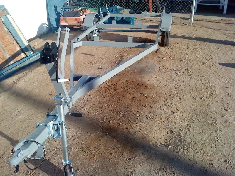

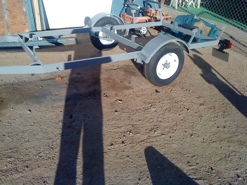

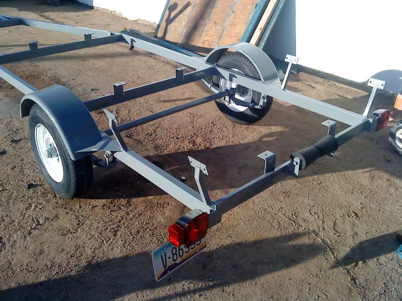

Well got the trailer sprayed yesterday and did not come out like I hoped. The sub-straight (old paint) must of been a lacquer base paint because the urethane did not like it at all and cause some major "fish eye" but was able to cover it up with a few coats. I also installed my new lights (still got to get SS screws for my side markers) and ran all new wire. Also installed a new tongue jack, painted the winch, and transom saver. The bearing buddies should be here Friday along with the bunk carpet. I also managed to get 3 coats of Thompson shot on some of the lumber I'll need this weekend.

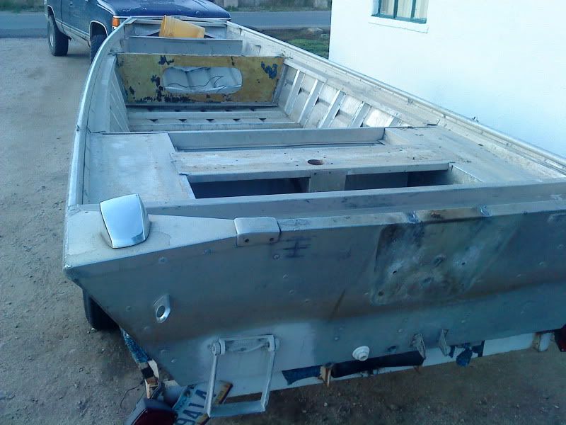

Tomorrow I'll be drilling out the bad rivets on the boat, pressure wash it with some purple power, and clean the aluminum with some tri-sodium-phosphate and have the boat ready for the trailer.
Still trying to find someone in this small town to recover my "main" seat for me to match my "bass" seats. So far it's either drive 80 miles each way to my old upholstery guy or buy new for $200. Orrrr..... I ask the wife for a sewing machine....lol. Now you can't take away my man card for that comment but I watched in my old shop our stitch guy and learned a lot and always wanted to know how so..... :shock:
Oh and also picked up a NIB Bass Pro 5/5/5 on board charger for my rig for $65 and had to buy it! Also still trying to decide on hinges SS or chrome or zinc. Also filled to boat with water last night and only one leak over 3 hours and it was from the live well pump intake in the transom and will be a easy fix!
At any rate here are some pics....

I managed to replace all the bad rivets now and added some chrome plated bracing to the weak points in the boat.
I also got the trailer done, carpeted bunks, foot pads, and well covers.

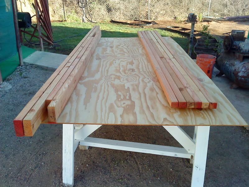

Got the few welds that needed done, done and cut out the ply for the floor. Went to wallyworld and got some battery boxes and started playing with mounting and think I have it nailed.
