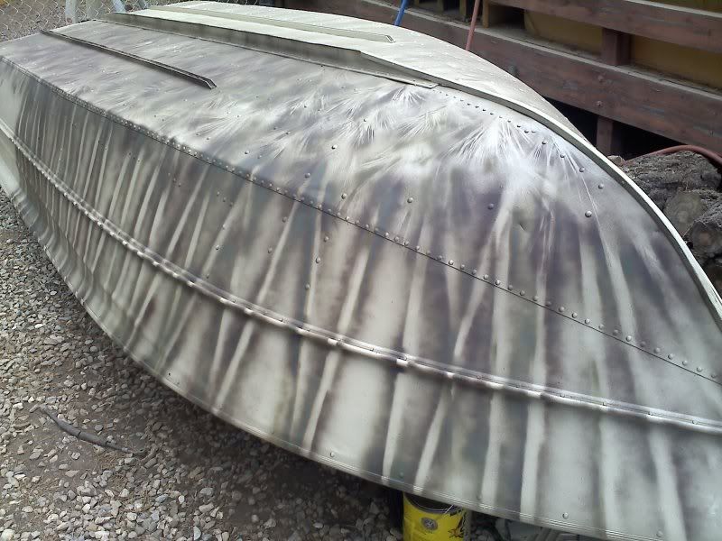

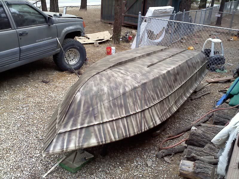

I started By filling her up with water to see if there are any leaks. I then filled the small leaks I had then painted the outside. I did a duck boat camo. I used an oil base tan paint. Then used camo spray cans to make the effect of camo. Here is how it turned out.
This is the section I tested on:
And here is the finished product:
I used pine needles to do the bottom and pvc pipe to create the stick pattern.
