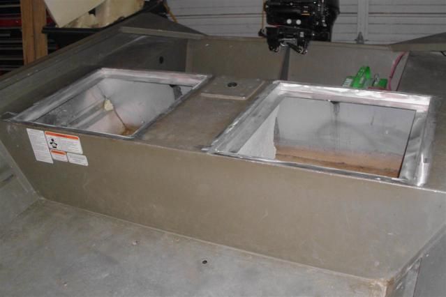

Anyway, a local customer came to me wanting to add a bit of storage to his bare bones Tracker 1448. As the boat isn't used strictly for fishing, he didn't want to loose open floor space by adding a deck extension, instead opting for placing storage underneath the aft bench seat. Also, he decided to install a lid over the aft battery compartment, to grant some deck space in the area that used to be dead space.
Here's what we started with. A clean Tracker 1448 w/ 15 Mercury.
First step is to cut holes in a perfectly good boat, weld in brake formed angles, then blend and fair.

The next step is to carpet the boat.
Then, we fabricate some drop-in boxes, followed by bending a set of lids.
The shape of support lip for the box provides a built in coaming, thus all of the water that drains off the top of the lid will not go into the storage box, and will instead drain into the bilge.
Install a bimini top, and you have a boat that is ready for the lake.
Here it is ready to leave. I don't have any pictures during construction, but you can see the lid over the aft battery compartment.
