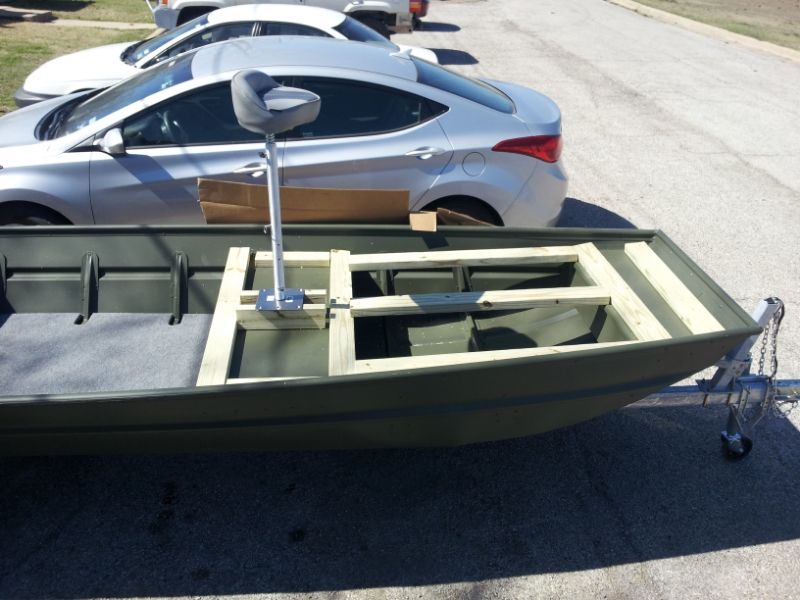

Hey there im a new user of the forum, i have owned 2 Jon Boats and 1 Bass Buster boat and finally got the go ahead from the wife to get something new and build it up for this summer. This weekend i am picking up a brand new trailer and boat from Academy Sports i decided on 1436 because i go fishing in small lakes and rivers mostly. So far i have drawn up a sketch of what i want the boat to look like let me know what you think.
Plan is getting a 45LB front mount foot controlled minn kota motor for now and maybe later finding a good used gas motor(most lakes i fish dont allow gas)
I also plan on uses 2x4's for the frame work and 3/4" marine grade plywood and lowes or HD outdoor carpeting.
I am in the Army at Fort Hood so hopefully things don't get to busy where i can build it up pretty quick
Thanks again and let me know

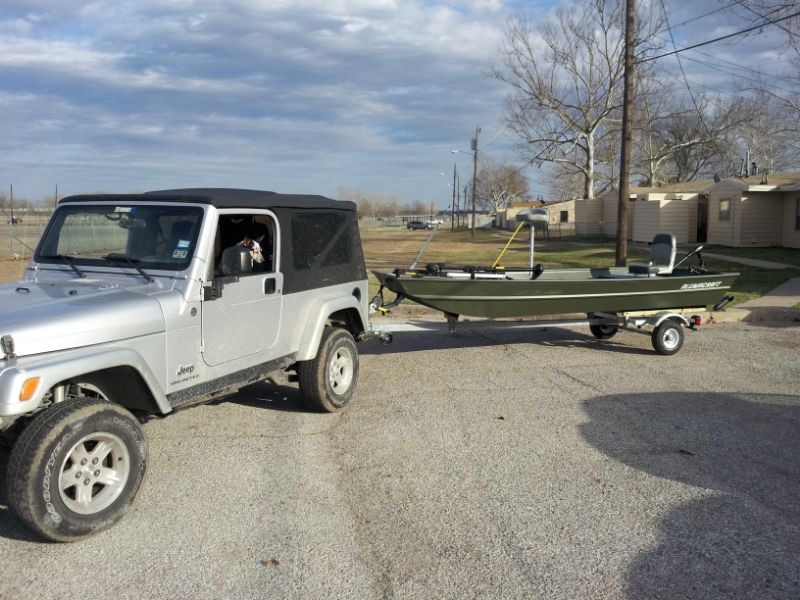

well i got the boat on friday and it looked like this Image

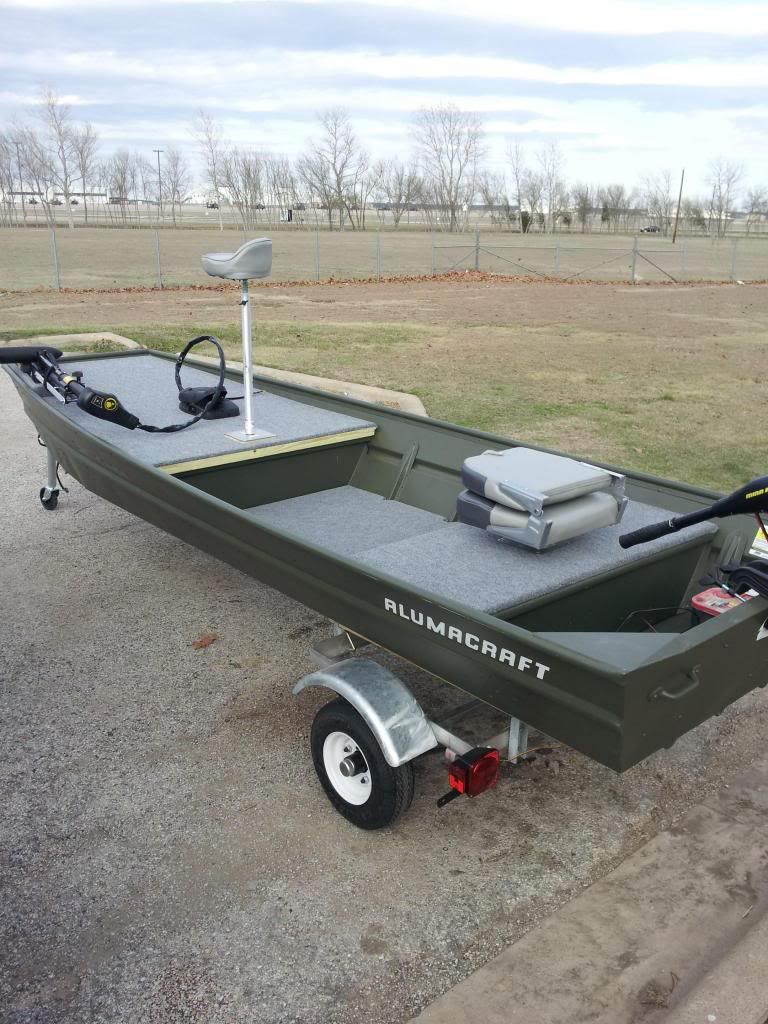

And now it looks like this

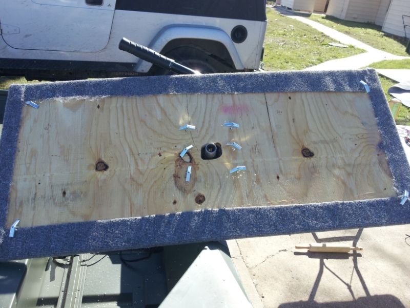

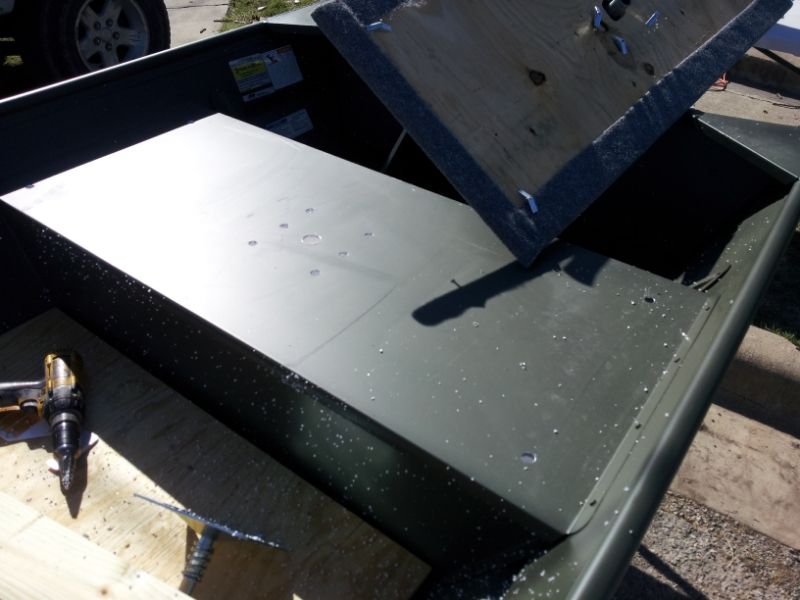

I will post pics i have of the frame work, i didnt get many of the front deck but i used 2 x 4's and some of the little joint thingys you buy at HD or lowes worked out great.
Also toggle bolts changed my life i have never done much with wood but wow they make your life easy... carpeting sucks so bad to do and watch your dog it will get in the glue .
Im gonna box in the front area where there is exposed wood and also i plan on making the left hand side console and a batt compartment in the back but this is where i got over the weekend
Let me know what you think

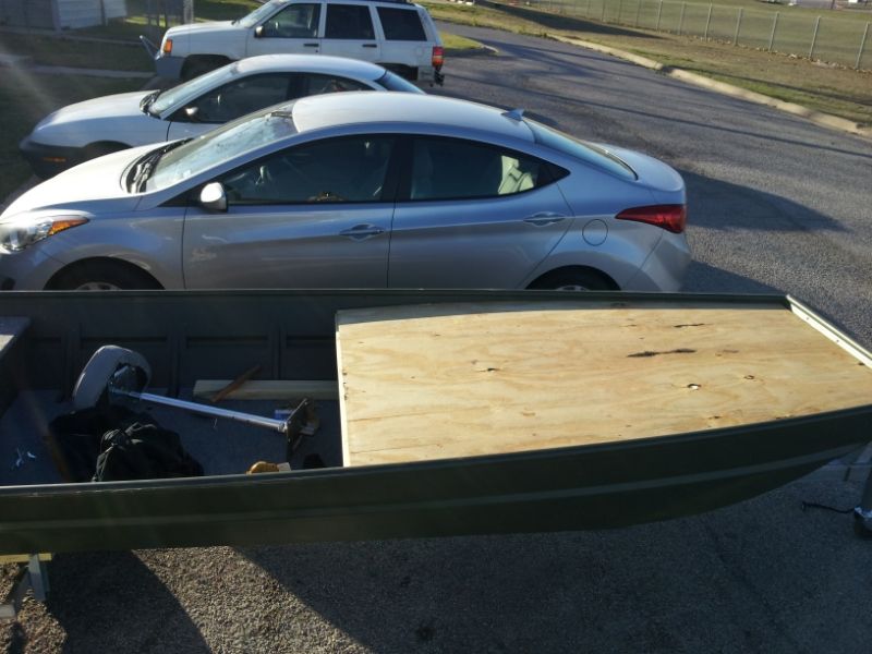

few updates on the pictures from the build
sorry didnt get any pics of the completed deck framework i got to into it i forgot hope these help... It's super windy today so i cant do much but i am planning on parrelling my batt's and runing some wiring. I dont think i will be able to cut wood and do any more carpeting today or get to take it out for a test.
updates to follow...
Plan on taking a video with my GoPro on the test so people can see the stability of the deck on the water... Stay tuned

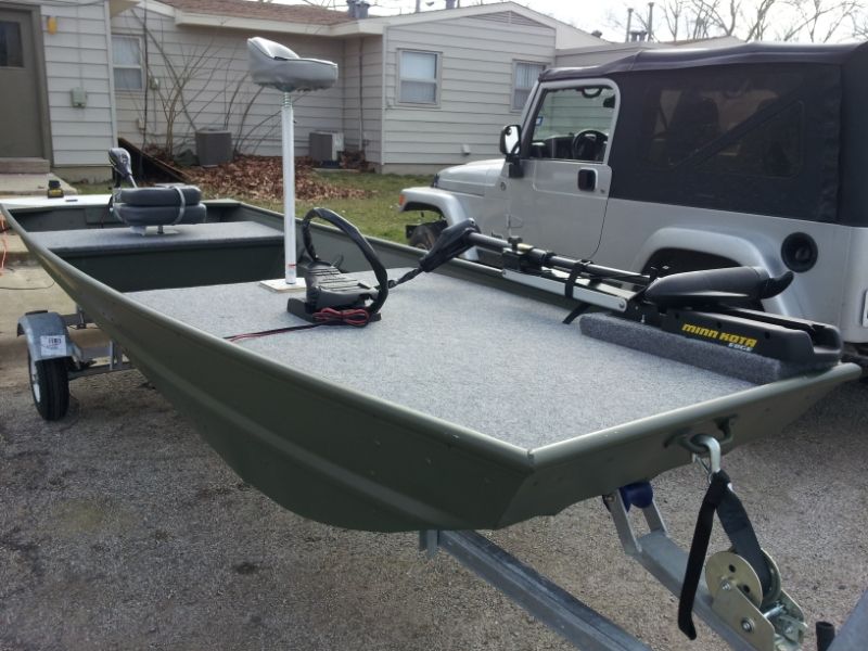

Well i did a test run then a fishing run in the last 2 days.... Boat works great.
Stability is pretty good and was about what i thought as long as the 2 people communicate a bit its not so bad the boat will wobble a bit when the other person moves but as long as your not just hanging out you will be fine..... Fishing alone is ZERO issues

Today me and my friend went for 3 hrs after work and i leaned against the front deck seat and trolled around the entire time(windy day) i felt like it was perfect for small lake fishing
And here is a picture of the first fish caught on the boat, many more to come Feb. goodbye march here i come
Also here soon i will be doing some updates for the little things i wanted to put on my boat: Wiring, cup holders, and pole holders stuff like that ENJOY!!!

hardest thing was figuring out the front deck, make sure you figure out where your supports are below before you mount the front deck so you know where to bolt it down at...
