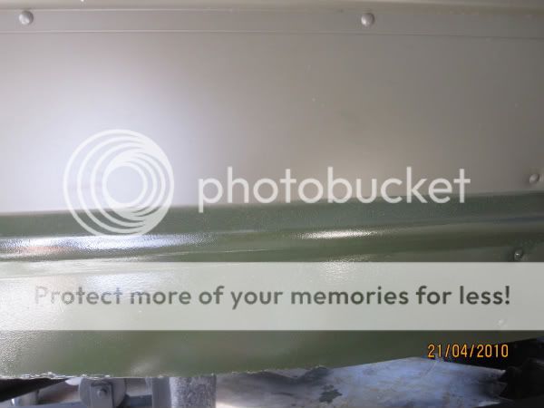

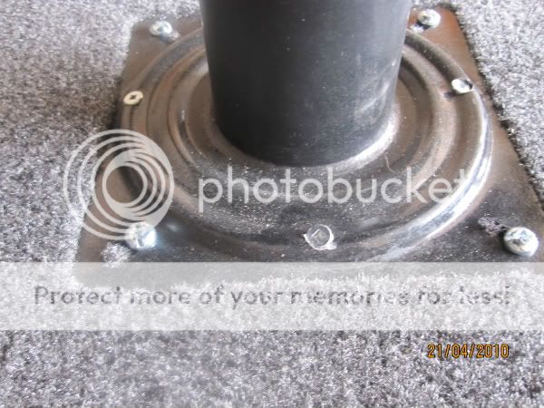

Its all 3/4 inch plywood, sealed with Thompsons. I tried using a bunch of types of self tapping SS screws, I found that they did not hold very well. I used toggle bolts for all areas going into the aluminum, they worked very well. Also the boat got 2 nice coats of Steelflex, to be honest i wish I had more because i would have liked a third coat. The carpet is the marine grade from Home Depot, used staples and outdoor carpet glue to secure.
I stripped all the old hardware off and replaced. Primed and painted it black

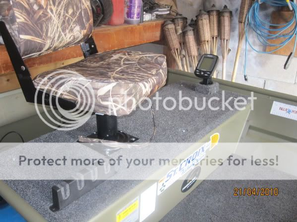

here is both seats mounted, and floor is snug in place

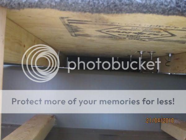

I used 10 toggle bolts to secure my 3/4 inch ply and my pedestal seat to the original bench seat. It is very secure, hopefully it stays that way

Nice I have the same boat how exactly did you attach the wood to the bench seats? did you use anything under the metal or just the toggle bolts?

BassinFool wrote:Nice I have the same boat how exactly did you attach the wood to the bench seats? did you use anything under the metal or just the toggle bolts?
I just used a 5/8 drill bit to drill the holes in the bench seats. Honestly it is super secure.

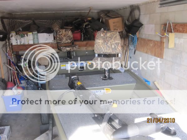

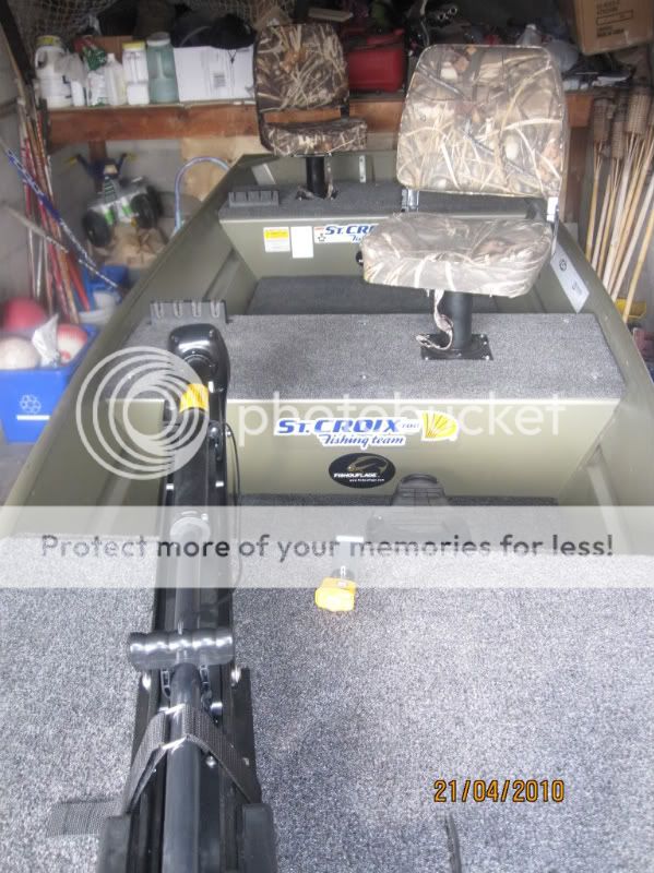

new pics.

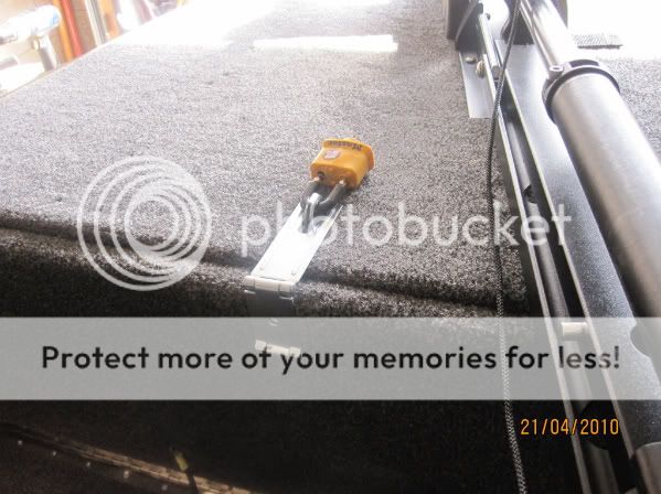

All finished other than the electrical part that my electrician friend is going to do for me.
Very happy with how everything turned out.

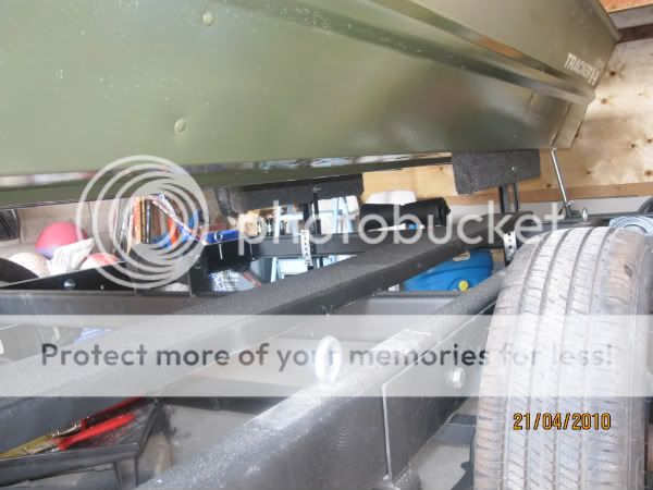

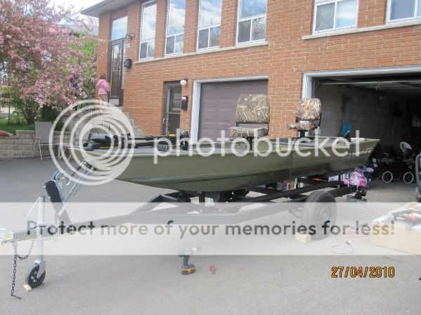

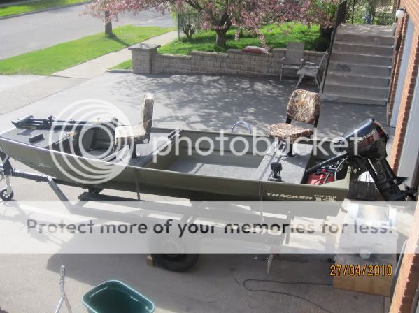

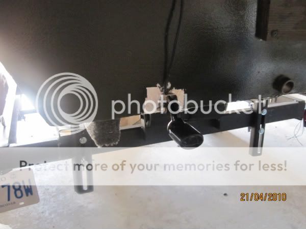

So i wired the trailer myselft today because my electrician buddy is too busy and it all actually worked. Here are more pics out of the garage

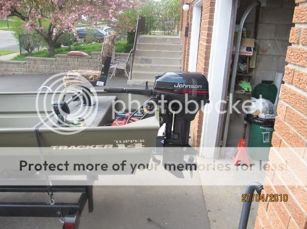

Also i put my motor on the boat today, i fired it up and it smoked a whole hell of a lot. is that normal. i let it run in my makeshift water basin for like 15 minutes. I bought the motor from a marina. The guy that owns the place ssays he would fix it if ever anything happened to it. Also he said it had not been used in years, could this be why it is smoking? Here are some pics of the motor mounted on my boat
Do i have to bolt the motor using the hole provided or are the vice style tighteners enough

Cali, Boat looks fantastic, I like what you did with the front the storage is a bonus. As for the motor, did it smoke the whole time you had it running? It should have burned off any residual oil that might have been left in the chamber. Also what ratio of oil are you running? I do believe it should 50:1. which would 16 ounces oil to 6 gallons fuel. The motor does not have to be bolted on but if you dont plane on taking it off it would make it that much more solid.

The motor smoked bad when I gave it gas. I did do the 50:1 mixture. If i bolt the motor to thr boat is that above the water line or do I need to use marine sealent.

since its only a 15hp i wouldnt bother bolting the motor unless theres a chance of it gettting stolen.

Don't bolt the motor and take the boat to a lake and run it and see if the smoke issue clears up. A motor sitting in one spot spiting out smoke seems a lot worse than a motor pushing a boat. Once you get moving it might not seem to smoke as much.
