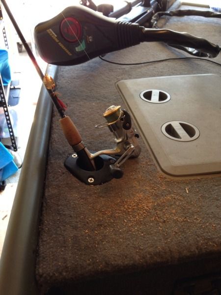

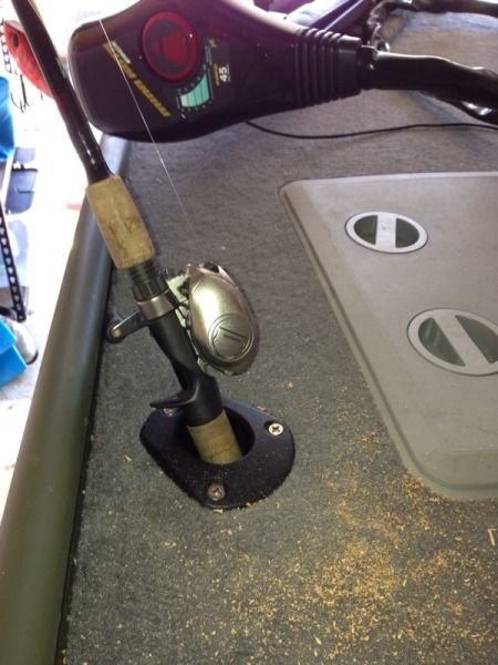

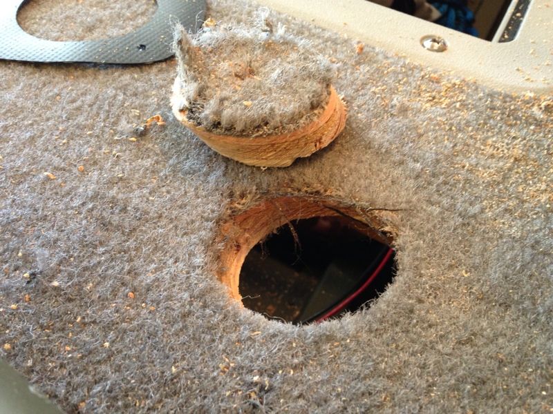

Just a new little addition I just did. I have a habit of putting my rod down to do something and leaving the line still in the water. So instead of one day a fish pulling it in the water I decided to put a flush mount rod holder. I used a hole saw and after the pilot bit started I slowly angle the hole saw to match the angle of the mount. Slipped it in and screwed it down. 5 min install and just what I needed!!

I like the rod holder idea. What holder did you use?

BigTerp wrote:I like the rod holder idea. What holder did you use?
https://www.amazon.com/gp/aw/d/B0024ALB4 ... -1&pi=SL75
