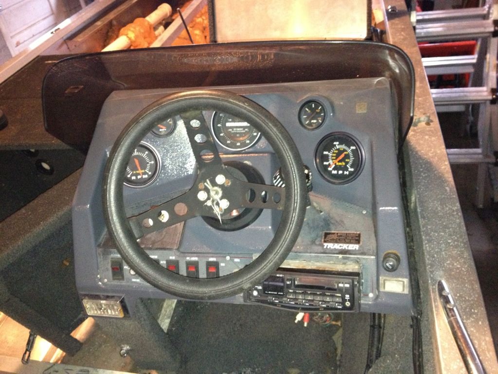

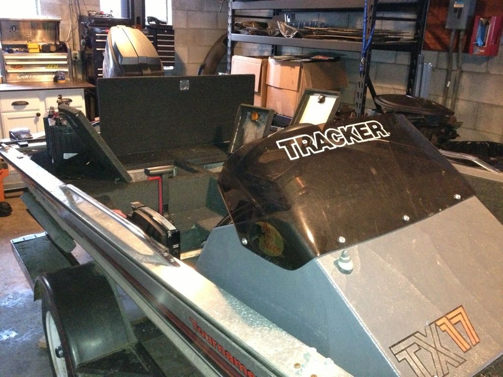

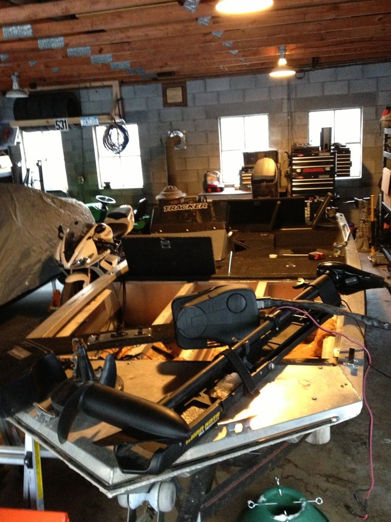

Since i am new here i figured i would start a build thread to track my progress. I picked up this 88 bass tracker this past weekend and have started working on it a little in my garage.
Things i want to accomplish:
New deck
New carpet
New seats and pedestals
New switch panel
Add a radio
line-x the center console after repairing/modifying the fiberglass
line-x the storage bins in the rear that are all aluminum
make a couple storage compartments up front
tidy up the wiring
here is what i've got:

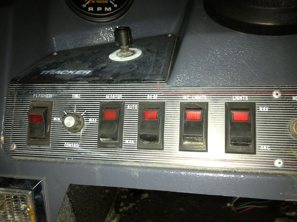

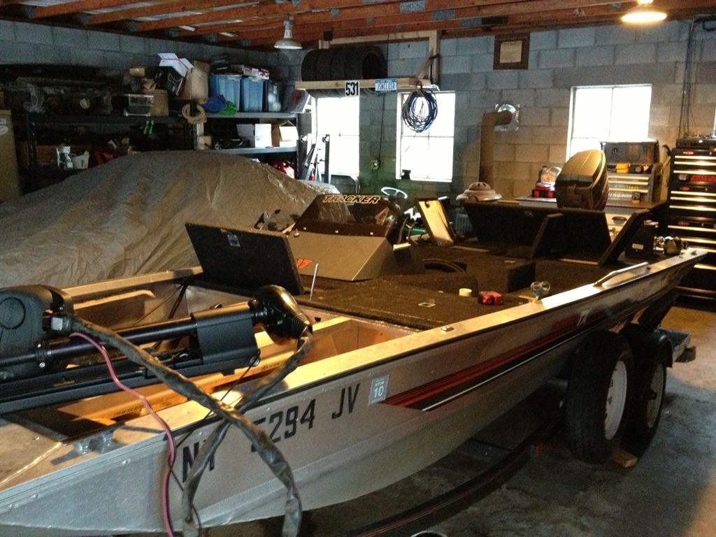

Got all the carpet up ysterday, now i just need to get some aircraft stripper and get everything super cleaned up for laying down new carpet.
Also did some checking on the wiring, and it's a mess. Nothing seems to work from the cockpit if i just went straight off the wiring but when i tested the trolling motor, bilge pump and livewell pump straight from them they all worked fine. So i'll be pulling all the wiring and re-doing that as well, which i pretty much expected to. I also tested my minn kota anchor and it works going up but can't seem to figure out the wiring for it to go down...i posted a question in the elctrical forum so hopefully someone knows the answer, i'm sure it's simple but i didn't want to fry anything.
I know it looks like a mess but it's getting there, i need to shop vac out the middle section and strip the aluminum down and then just start laying carpet.
