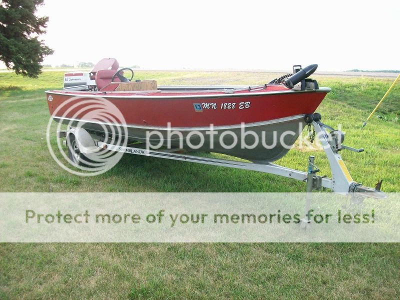

Picking this up Saturday:
18' mr pike , 1984 I believe. The motor is roughly the same vintage but the owner isn't sure. The motor has a new water pump and impeller this last fall, and the guy will be taking it out of barn storage to sell it to me. Is there anything I should check or look at before buying? This is my first remote steer boat.
Turning it into a big water duck hunting rig on a budget, any suggestions for decoy storage or hard sided blinds are welcome!
My list for so far:
1. Remove giant casting deck in rear, make something way smaller for gas and battery storage
2. Remove carpet and possibly floor if flor is bad
3. Change paint scheme to something a little more duck "friendly"
4. Remove trolling motor
5. Lengthen trailer or get a different one
6. Add in lighting and storage on the cheap
7. Build the duck blind with a spot for the heater
Anything you can think of let me know!
Paul

FishnutZ thank you sir! That is a great idea! Are those bolt on usually? I used to weld professionally on steel (no aluminum... Dang it!) but that would be great so I may actually be able to get it in the garage! I assume I want the rollers to end up right under the transom, just like bunks? I've never owned a roller trailer.

I should be able to run it, I had him do a compression check as well: 120, 120,119,118. Looking good!

Got it home today! Turns out the boat is a 79 and the motor is a 77. I will probably be replacing the motor with something newer, not sure if it'll be two or four stroke yet. Everything pretty much checked out, the typical depth finder holes in the hull, needs a new radio antenna, and the wiring looks sub par. Lots of little things, no major flaws.

Hey guys, I didn't really find any soft spots on the floor and I tested the transom by pulling up and pushing down on the motor while it was tilted up, it didn't seem to move or be squishy. I will be pulling the carpet so I might as well just replace the floor I suppose. What's the best way to get carpet glue off? There are carpet strips on the "rim" of the boat and on top of the console that I will be able to remove and replace with the new color of carpet. After I get it stripped and painted. 8)
Anybody know the going price for a 77 Johnson 85 horse that works with controls? 1k?

Ripped out the rear platform and started taking up carpet and seat mounts on the floor. took out the floor mounted battery box. Man, the wiring ain't purdy. I will try to continue taking out the carpet tomorrow if I can get the seat mounts out...
