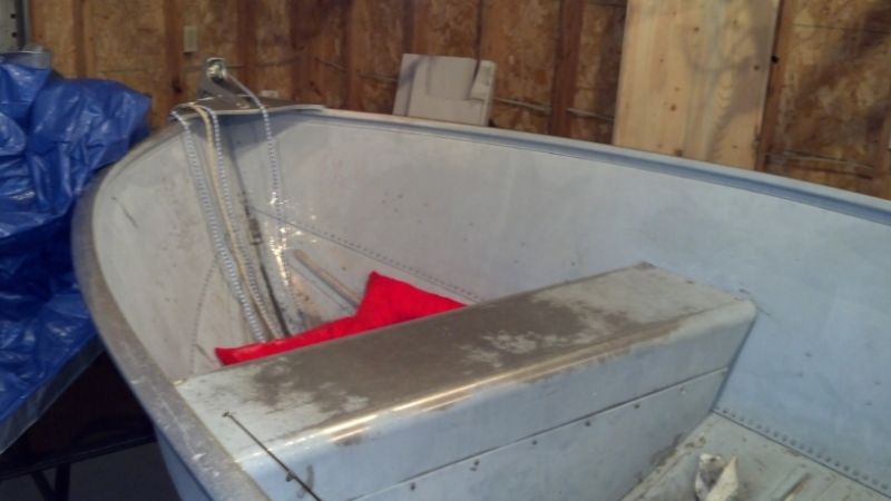

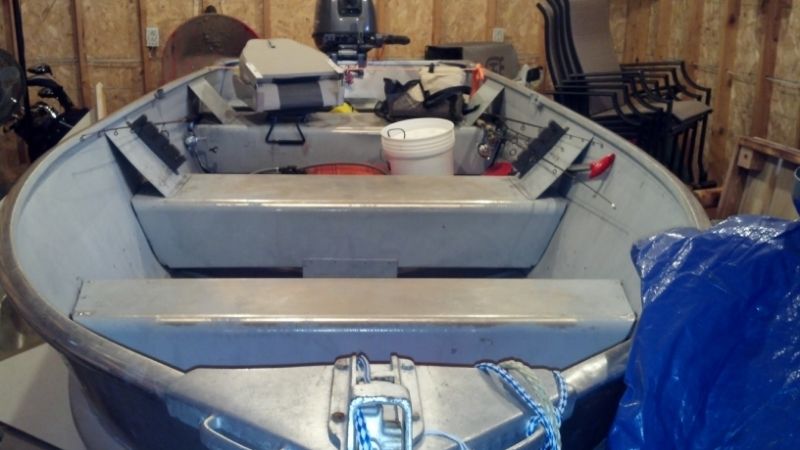

Here is what I'm working with:
'82 Sea Nymph sardine can that works great, doesn't leak, and is the perfect size for a solo fisherman up in the northern part of MN. Heck, I even hit some rocks at full tilt and the only thing that was damaged was the motor.
I've got a 15hp Yamaha 4-stroke, a new (old, but new) fish finder to install and a bow mount trolling motor to find and hopefully install as well.
I fish for anything that swims and need a solid layout and design to go with. I'm looking for advice as I'm in the planning stages right now and MN winter isn't letting up anytime soon. I need storage for life vests, anchor, bait bucket, and the rest can be packed in and out.

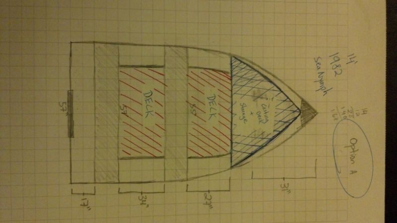

I am planning on creating a deck, but to what extent, I am unsure. I am attaching two basic (very basic) sketches of what is in my head. My main concern is removing a seat and losing lateral stability. I also want to make sure that whatever I do doesn't ruin any resale value because this is my first boat.
Here are some pics. Let me know your thoughts!

Hey big bro. This is gonna be sweet. I like your sketches, looks like a solid plan to me. Plan b that is. You can always turn the bench into a walk through bench as well, and keep almost all the lateral strength.

Thanks for the feedback guys. She's pretty solid. I think I've decided to go with my option "B" and possibly maintain 20% of the original seat to keep the bracing the same while using the existing support to help the decking.
Right now I'm looking at using the existing front seat as support and keep the casting deck on that same level, but I'm stumped as to how to create a support from the bottom of the "V" to be level with the seat in order to put the plywood down and have it remain solid.
The question is:
What is the best way to build the structure to support the casting deck/storage and what should I use? I only want to do this once, but I also have a budget. I've seen everything from foam, 2"x2" wood, to square aluminum tubing. What's the best solution? The easiest to work with?
If anybody has blueprints or notes for me to work off of I'd be most appreciative.
Any thoughts?

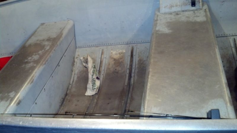

I then started thinking about using the space underneath as storage. The way it is set up right now the battery won't fit underneath the center beam unless I take it out of the battery box. Suggestions?
I wanted to make sure it wouldn't tip over at any point so I added some 1/8" aluminum angle to support the sides. I cut (4) 6" pieces and riveted them to the sides. Hopefully well above where water will ever go, but I plan to put some silicone on them to make sure.
I really do need some help on the next part though. I am conflicted as to whether or not I want to take out the center seat. My only concern is that it looks as though it might be part of the structural integrity. Does anyone have experience with this? I'll highlight what makes me think this in the image.
Let me know your thoughts. Thanks in advance.
