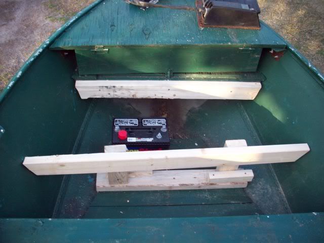

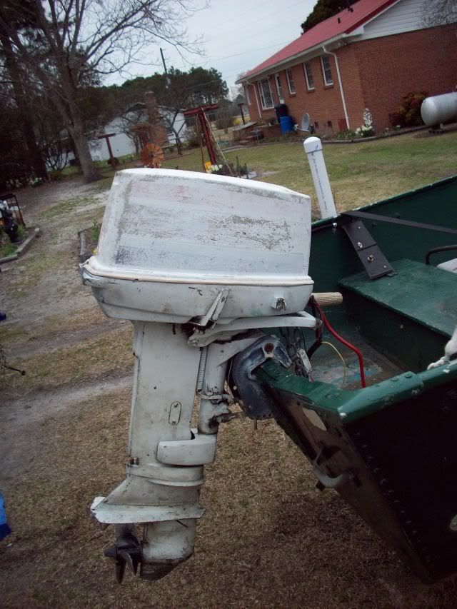

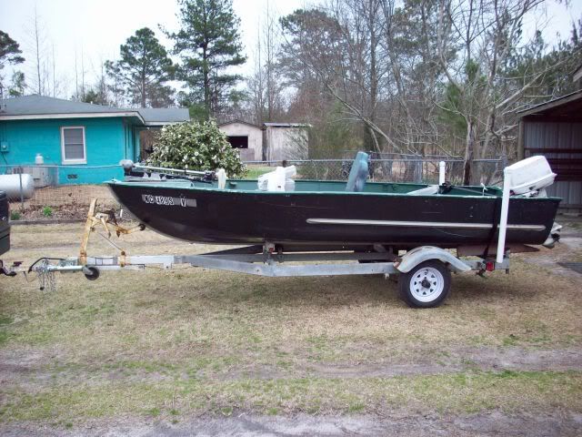

I finally got my boat sea worthy!! It is a 15' V hull 1972 Monark with a 79 25hp Johnson on it and an old motorguide trolling motor. I had to do a few things to the trailer its on such as new rims and tires and leaf springs and to the boat i repositioned the trolling motor to make it more secure and gave the gas motor new spark plugs, new wires, new water pump and and two transom mount bolts instead of big wood screws. There are also a few other modifications i want to do to the boat. I want to add a deck to it (not a real high one) with some storage space such as a rod locker, a live well, and a place to keep battery out of my way. The boat has three bench seats in it that if i could take the middle one out to provide more space. But the middle seat is riveted in. How could i remove it, and if so will i lose hull support and could this support be replaced or would it affect the boats performance drastically? If anyone has any suggestions please reply. I plan to get pics up soon so bare with me.

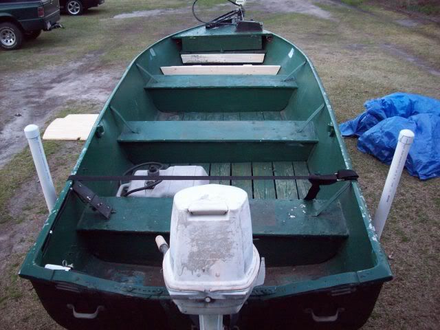

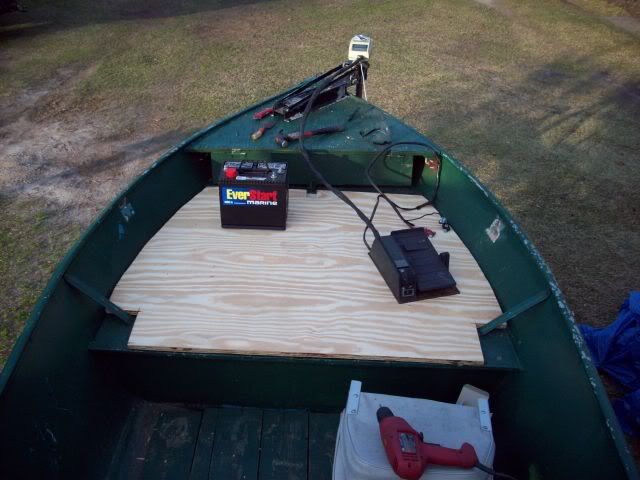

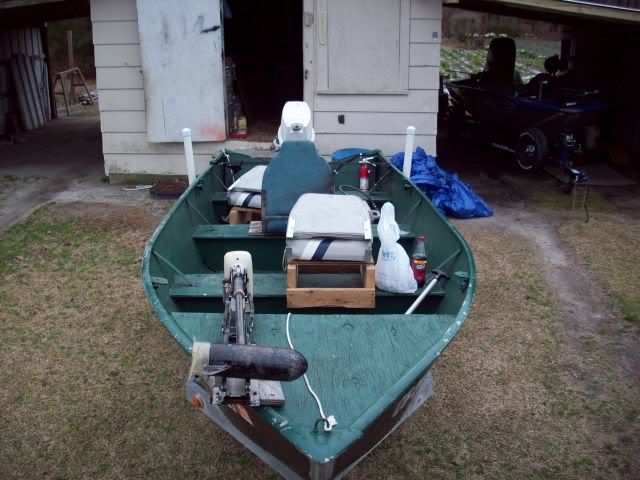

Got some pictures today and also started working on front deck let me know what yall think.

I would say it has potential! The front support for the front deck, how is that supported, looks like it is screwed to a factory bench correct?
Also, yes you could take your middle seat out, I sure know I would want to, but yes you would be losing some support/structural integrity, so yes you would want/need to do some redneck engineering to make up for this, but it certainly can be done. I haven't done it personally, but there are so many examples on this site of people doing it, seemingly successfully. As well as different schemes for bracing it up etc., that I conclude yes you can! So do some lurking, get some ideas, and I'm sure you'll figure out a way to do it! I think it will be a lot of work though...

The front support for the deck is screwed into the front seat and it supports the front deck nicely. I have a few more pics of the front deck carpeted and with a seat on it so as soon as i get the time i will post it. Also, the motor runs great! only porblem is that it sometimes wants to jump out of gear, maybe the clutch dog. I need a new prop for it cause its all dinged up and scratched. I have had it on the water fishing about four times since I've had it. Only thing is I took it off the trailer to start paint about a week ago and have not even touched it yet because of school. But school is almost out and i should resume progress soon, hopefully tomorrow. Thanks for the pointers, though.

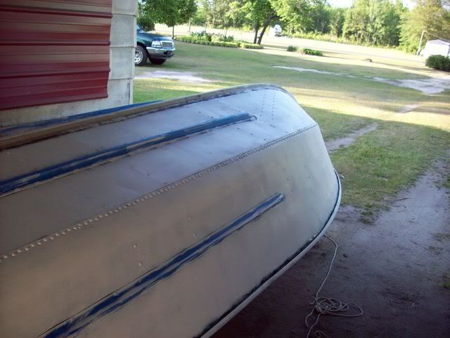

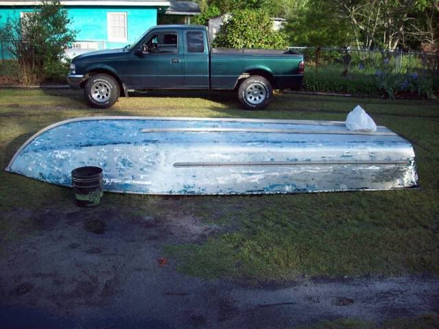

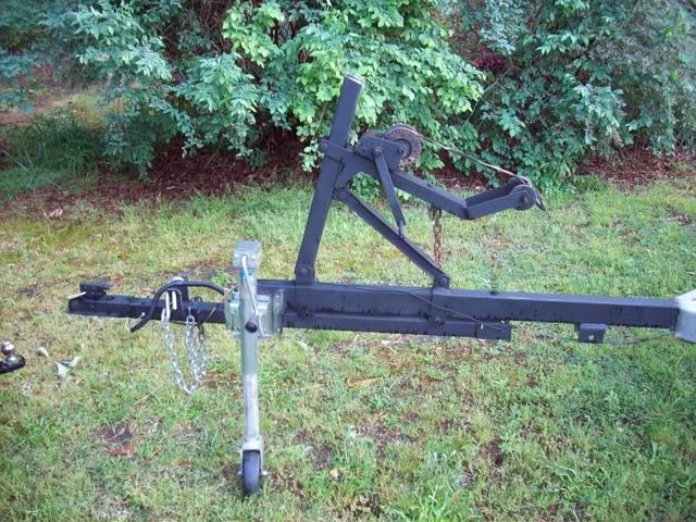

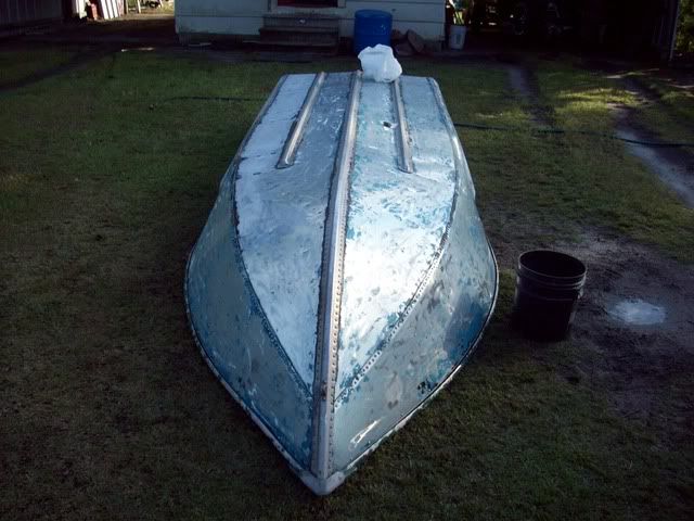

Finally got some pics of the painting process! 4-27-10 I used paint stripper to remove the paint from the boat. Worked very well but messy. Also got the tongue of the trailer painted black instead of it looking rusty. Hopefully, I will apply paint to it Thursday afternoon!! Let me know what u think.

Post by dyeguy1212 » 27 Apr 2010, 23:51
Looking good... removing paint is always the fun part...

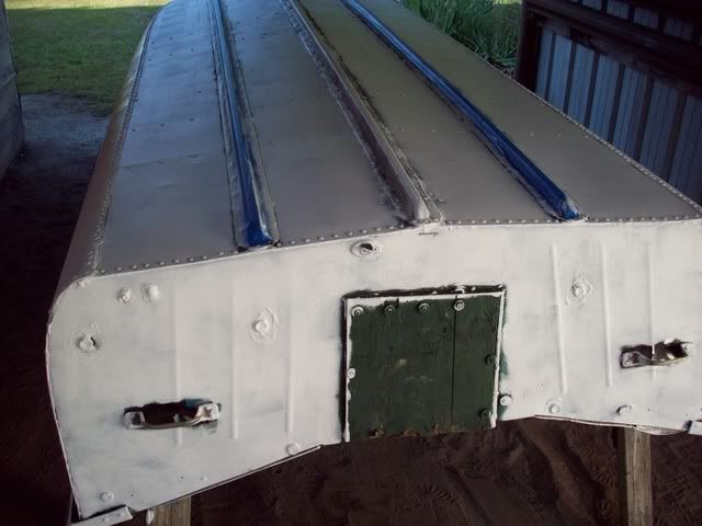

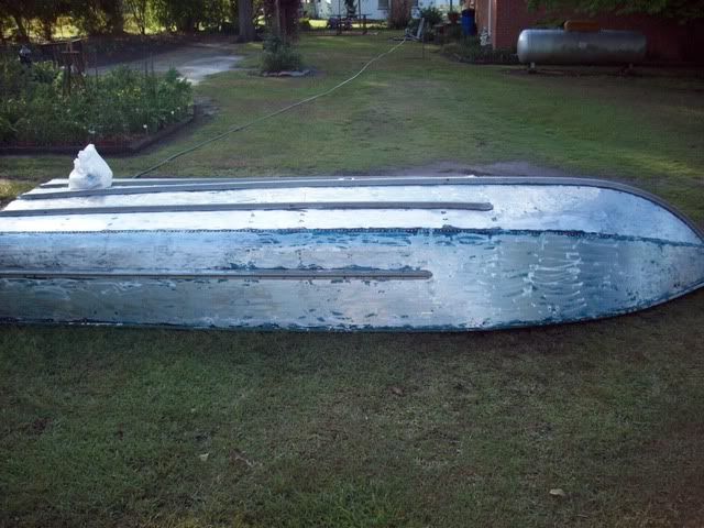

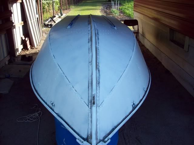

Post by alanbird_87 » 29 Apr 2010, 19:05

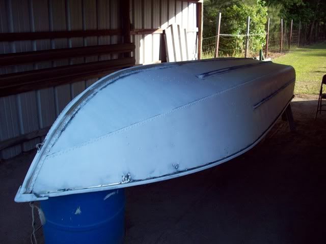

Some more updated pics 4-29-10. These are some pics of the primer application. Hopefully i can put some paint on later this afternoon!!!

Post by BottomDweller » 30 Apr 2010, 22:49
Just looiking at your trailer and trying to see what was done with the tongue. Was it cut and then an extension bolted on underneath?
