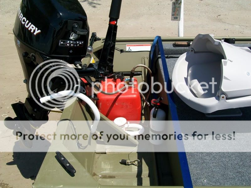

I dont currently have this boat, but this is a project I did back in 2009. wish I would have kept it :( but at the time I had about $4,000 in it and felt it was waaaaaaay too much.
Unlike the super set-ups on other custom jons, I tried to keep this relatively simple. The boat is a 2008 Lowe 1436L, the trailer is a 2009 continental, the motor is a 2007 Mercury 9.9 four stroke, and the trolling motor is a 40 lb thrust Minn Kota. Everything was bought 5 weeks before the finished pics were posted. Boat and trailer bought new, motor slightly used.
deck frame - 1/8 x 1-1/4 x 1-1/4 aluminum angle.
these two vertical legs were eventually welded (see front floor pic below)
frame screwed to rib
floor - 3/4 untreated plywood, added thompsons water seal
front floor, under deck storage. you can see where the deck legs were welded
on the port (left) side, is what I call my accessory rail. I really wanted to have the rod holder and the rods would not fit right unless the holder was mounted at a certain height, so I added the 2x4 . switch box has a fuse board in it. controls power to the fish finder, bilge pump and front and rear lights
trolling motor mount (screw overkill ? :lol: ) up until this mount I had a hard time making a sturdy mount so I just went all out.
rear
all 4 rod holders in
on the water and almost ready to fish (just had to plug i rod holders)

i have a question. is the trolling motor made to be a bow mount because i have a transom mount and i dont like how it handles when trolling. i was thinking of a way i could make a bracket to mount it on.the only problem is that the steering handle would face forward and it would look ghetto. oh ya its a 35 p.o.t with a long shaft. any help very appreciated.
back4more
Posts: 71
Joined: 19 Apr 2009, 22:09
Lowe 1436L
Post by back4more » 26 Feb 2011, 08:34
the trolling motor pictured above is a transom mount. I just spun the head around. on minn kota endura TMs it should be as easy as removing 1 screw under the head unit. there may have been a slight pain getting the wires to stay out of the way when putting the screw back in. the screw goes through the shaft and so do the wires for the head of the unit.
