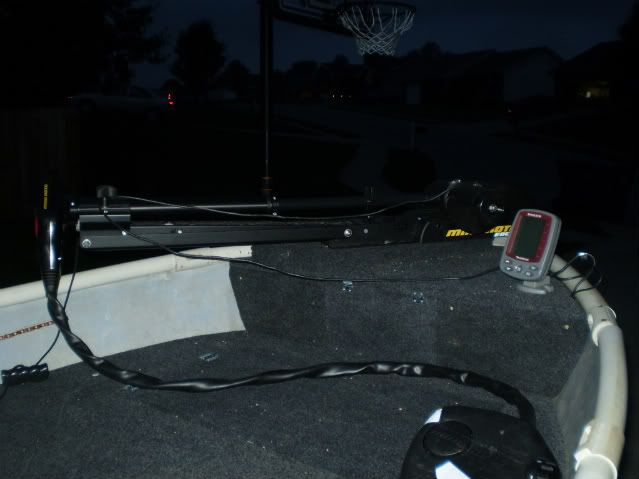

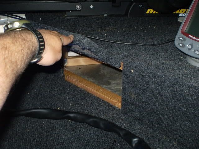

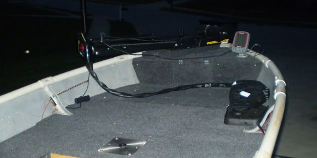

Trolling motor deck and new trolling motor. I also mounted the front fish finder and added storage hatch so I could store some stuff under the tm deck. I don't want to waste any space.

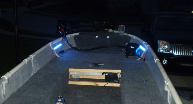

View of full front deck. There are two storage compartments(hard to see them) and they are lighted with blue water LED's. Wasn't quite dark enough to get a good picture of them and then it started raining so I save those for later.
Another view of the front deck w/ my blue water LED's for the front deck. I went with the blue, but this isn't the greatest pic because it wasn't dark yet. The rain was starting and I at least wanted a picture of them.

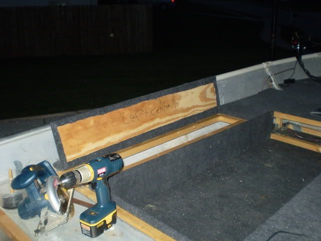

Left side Rod locker. Will hold at least 6 rods and is lighted with blue water led lights.

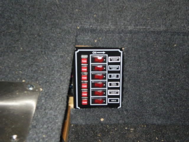

Right side rod locker. Will fit a couple of rods. Will mainly be used for misc. storage. Mounted the on board charger in this compartment and also a switch panel.

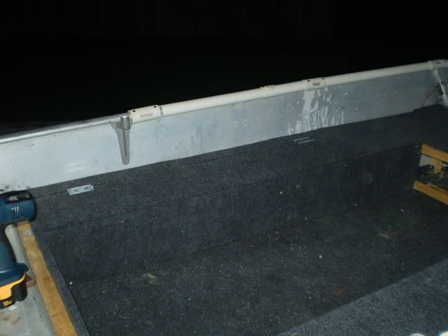

Back deck area framing. I still need to complete this section and mount the FF/GPS unit, but the rain started to fall.
Wiring is all hooked up to switch panel and I will finish up the mount after I finish the wiring for the trolling motor as I still need to get in there as I am extending the trolling motor wiring all the way to the back of the boat.

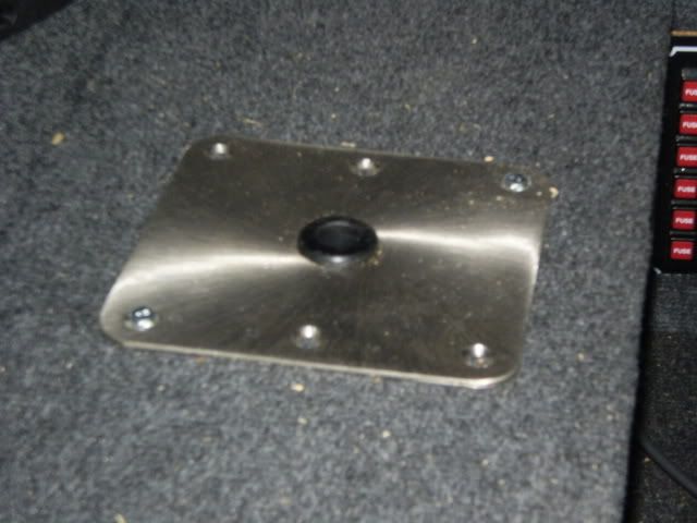

Got these at bps on sale. Got base, pole and seat mount all for 21.99 during one of the sales back a few months ago. It was over half off normal price. I got a set for the back as well.

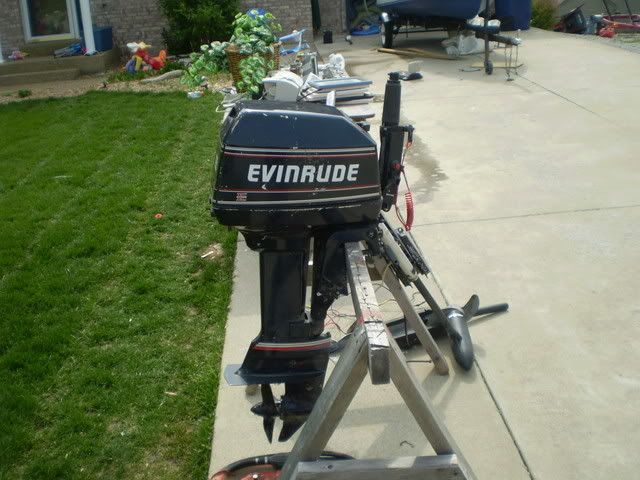

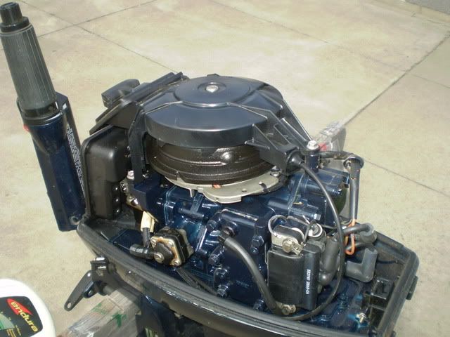

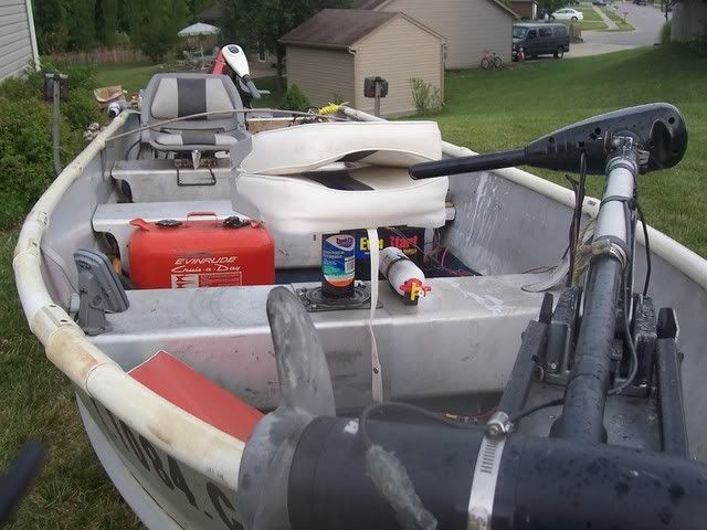

Got to decide what to hang off the back. I got both of these motors very cheap. First is a 93 Evinrude 8hp.. second is a 2006 B&S 5HP. Have less then 600 in both motors. I don't know jack about motors. The evinrude hasn't been run in 5years but is very clean. The briggs runs like a top. Got to decide whether to sell the evinrude and use the money for other things, or sell the briggs and use the money to have somebody work on the Evinrude.

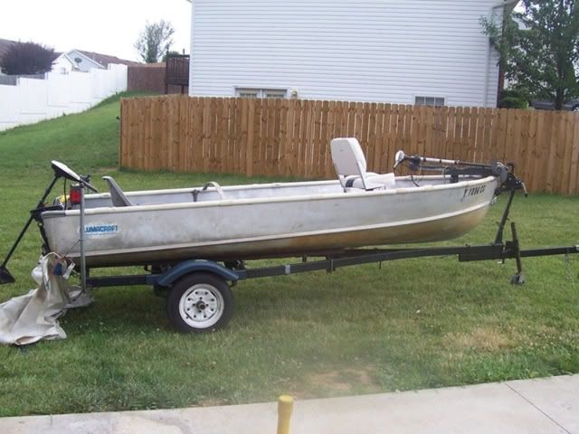

Sure has come a long way since:

Very nice man! The LED lights look killer! Tough choice on the motors, but you can easily sell either or. I have been following some other forums and craigslist, people always want small motors like those. Bigger is better in my opinion, but reliability and trouble freeness(Is that a word?) always come first.
