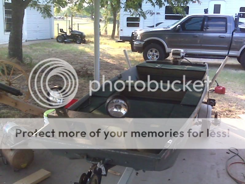

Here what I did to plan my mod: Go to any of the jon boats sites a copy a pick of the floor plan lay out. (1232; 1432; 1440; etc.) what ever you end up with. When you have save it you can insert it into say a word ducument. Then you can overlay you ideas on top. Like this.
Now mine is a 1432 so it is to narrow to deck up for fishing. So the decks you see in the next picture are actually storage, live well, and some rod boxes.
As far as my mod has gone i have spent a total of $86 on the boat, for wood, carpet, hardware (hinges; screws, etc) and some conduit & camo tarp to mock up a bimini top. The lights and diamond plated floor I scavanged from other projects or had lying around.
Also for stability I intend on installing some outrigers like you see for canoes / kayaks. I know this is not for everyone but I am big guy and want the insurance (I don't ming getting in the water, but on my terms, not gravities). I hope this helps ya out. You can also look up my mod "USS Clarence" in boat modifications. Good luck.
