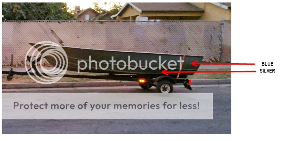

Really...just a quart. That's good to know. Here's what I'm working with. Plan on going with a blue and silver scheme.

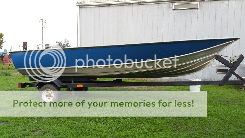

I began removing the old paint. I actually like the look of the bare aluminum. So I'm leaning towards skipping on the silver paint and only painting the top half blue.
Well, I did the roll and tip method. I must say, I felt as if I was laying down good even coats with this method. I did have to spray the self etching primer. After 3 coats of blue, it's looking pretty sharp. For under $45 this was a good little project. Hopefully if the weather stays warm, I'll be able to strip the inside and leave it bare aluminum.
Thanks again for everyone's advice.

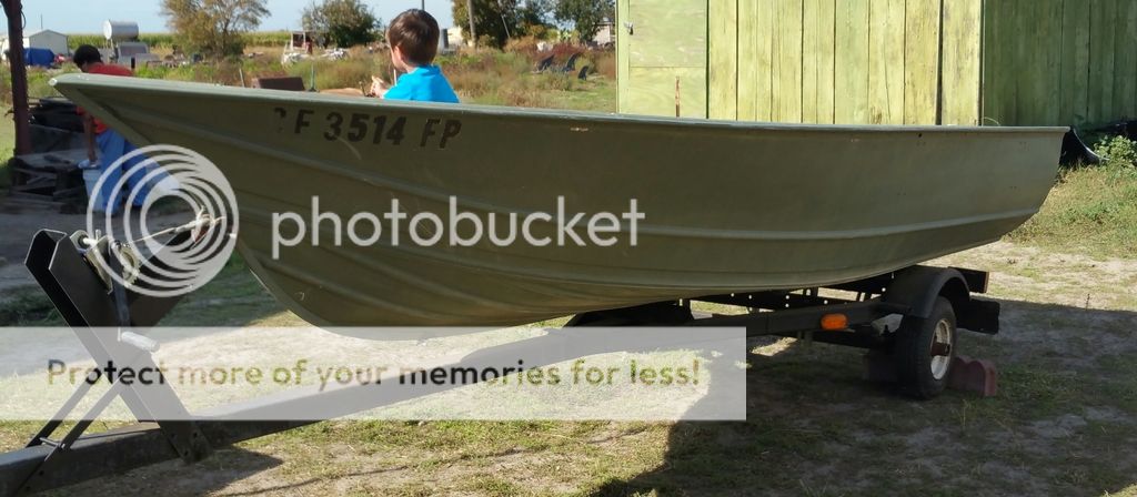

Before and after pictures:
