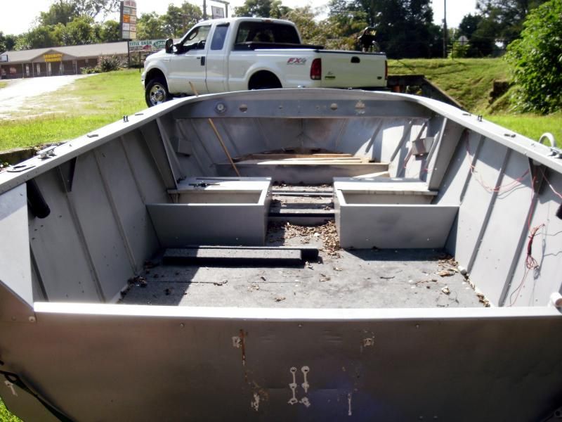

I'm helping a friend modernize his outdated Lone Star closed bow utility runabout. It's a deep semi-V, 16' long with a 76" beam:
The first order of business was to cut out the covered bow that wastes lots of good deck and storage space:
Then there's the old timey box seat bases:
Gone:

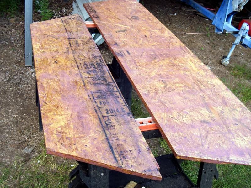

We're also using 3/4" tongue and groove subflooring for the decking. This board has no core voids and a 50 yr. warranty against delamination. We're fairing and sealing the decking with epoxy resin and SM fairing compound:
After the first coat of resin we fair (fill) the rough surface with the compound to smooth it out:
After a2 coats of fairing compound and 2 coats of resin we get this:
