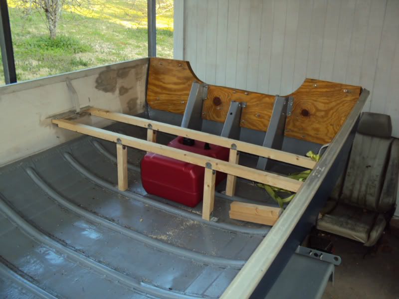

Small update. I spent a little more time working on the framing, but for the most part I just stared at the darn thing :? Trying to figure out where to put hatches, where are the batteries going to go, where will you mount the seat bases. Right now much more of my time is spent pondering than actually working. It is only a blank canvas once, and I want to make sure I account for everything.
I think the next step is to put in the flat floor between the decks. That will give me a base to finish the rest of the framing.
I know everyone loves pics:
I framed up the openings for two Tempress hatches. I'm thinking of building a platform in the middle to mount the batteris. Still need to add a couple vertical supports. I can stand on the deck as it is but I'd like it to be good and strong!!

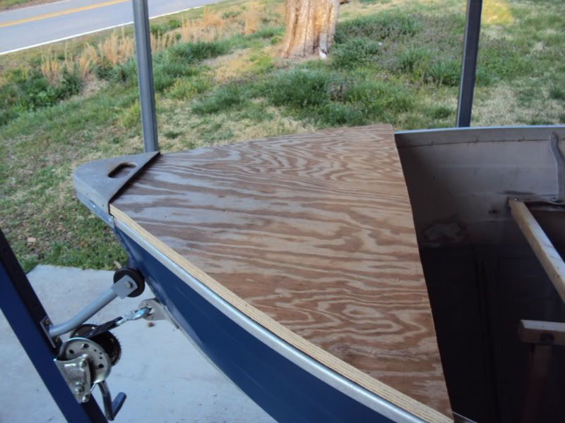

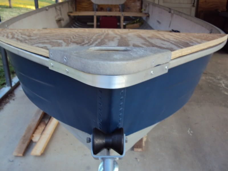

Got the trolling motor deck cut. I plan on staining it before I seal it!! The good news is now that the trolling motor deck is done I know how far to extend the front of the lower deck.
Not much work was done to the back!! The fuel tank fits perfect though!! I'm trying to decide whether or not I should extend the rear forward a bit for more of a platform. I plan to fish out of the front of the boat but I don't want my fishing partner to be cramped in the back.
Feel free to throw me some ideas!!

Lookin good, I know all about that standing around staring thing takes up alot of build time. I would bring the rear deck out one more rib IMO.

I did not sit and stare at my boat this weekend. I actually cleaned my garage up and made room for the boat to be sprayed. I plan on making my rear deck one rib forward of the seat mount. That extra 8" or so makes the boat feel more stable on my 14 footer. You framing looks good, I almost changed my mind and went with the wood framing, but I just don't want to have to re-do it. That is why my project is slow, buy the stuff a little at a time. I look forward to your progress.

You guys have convinced me, I'm going to extend the rear deck one more rib.

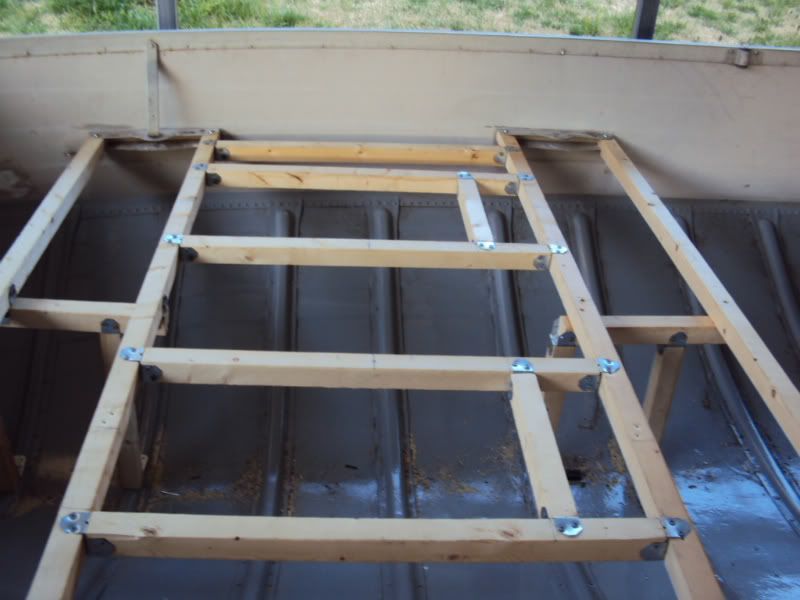

Well I spent some time working on the boat yesterday. I finished the trolling motor deck and got the interior framing about 99% complete. It is time to spend an evening crawling around all the framing so I can coat everything in spar. The bottom and sides of the floor I already mounted and all the framing underneath that section already have three coats on them. If I ever do this again I'll be using Aluminum!! I also picked up my pool noodles, I felt kinda silly standing in line with a whole box. There are about 25 noodles under the main floor as of now, and I have a lot more flotation to add.
Okay here are the pics:
I stuck the ruler down then put two additional coats of spar on top, It should never peel up!!
