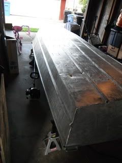

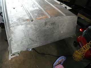

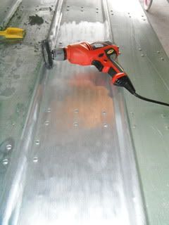

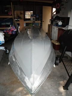

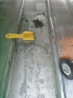

Here is the story, figured I would try 2 sample areas to see what would be more efficient.
I bought 1 quart of Aircraft Paint Remover (Temp. 80+) let is work for about 20 minutes. Seemed to work OK, but left a thin layer of paint. The clean up too much.
I then used a Wire Wheel (4") cut right through the original paint and 2 hours later almost 1/2 the bottom and side done. Had to stop, getting dark and did not want the neighbors complaining.
I could have worked all night, but have the whole weekend ahead of me. Finished it off with a nice cold Grain Belt Premium (MN people would be proud) well maybe?
Soooooooooo.........Addicting I am Hooked.
Tight Lines Fellas!

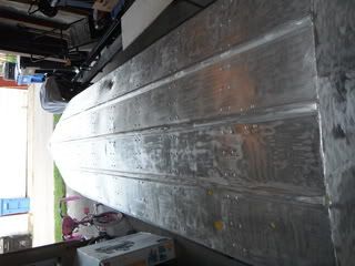

Productive Weekend
Total hours grinding away 8 Hours.
Filled some dings and heavy scratches with some epoxy, need to sand them down and level off.
Called Jerry at Fasco and ordered the Steelflex, going to go with the Gray.
Picked up the mixer attachment at Harbor Freight-$2.99, going to purchase some mixing cups at the dollar store, 4" foam rollers and I am ready to go.

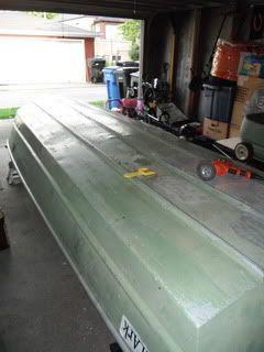

PostPosted: 04 Sep 2011, 12:38
Joined: 07 Jun 2011, 02:16
Posts: 53
Location: Chicago

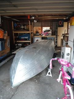

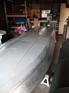

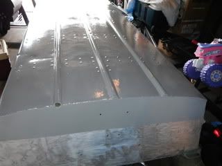

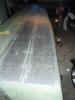

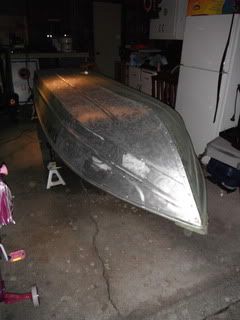

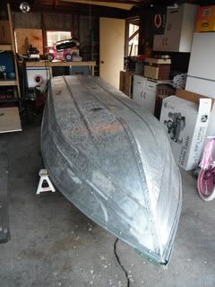

How summer slips by.
I had planned to Steel Flex the boat many evenings throughout the summer but ol mother nature has not been very cooperative. Everytime I scheduled to do this, the temp was too high, and the humidity, well lets just say to much.
Last evening was perfect for me, these pictures were taken this morning.
All in all it took 2 hours from the time I started mixing and applying, overall an exceptional job.
Prepped and wiped down with Acetone.
Don't fear the Steel Flex, easier than I thought. Just make sure you read through this forum, alot of helpful information and informative tips.
Thank you for all the helpful insight from the forum, could have not done without all of you.
Rob

PostPosted: 04 Sep 2011, 12:39
Posts: 53
Location: Chicago
Sorry for the Whiplash viewing pictures, I rotated them.
