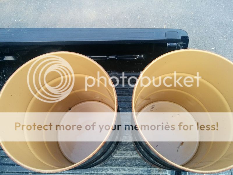

Barrels were used food grade barrels that stored honey.
The bad part about foot grade barrels is they have a liner in them that is hard to remove. Some don't remove it, but I felt better getting it out.

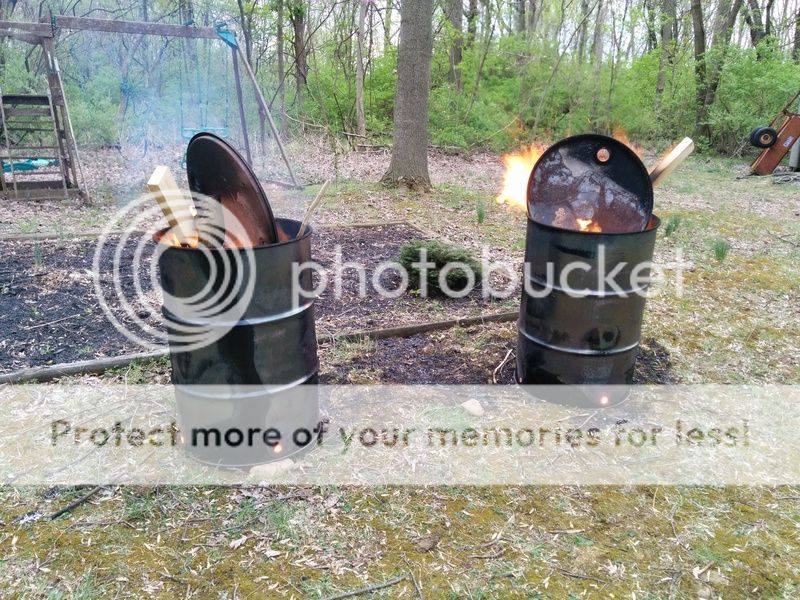

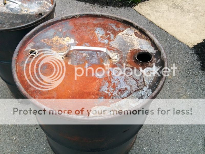

The first step is burning the crap out of the barrels. This removes the exterior paint and gets all the nasties out of the inside. The liner in ours partially came out during the burn.

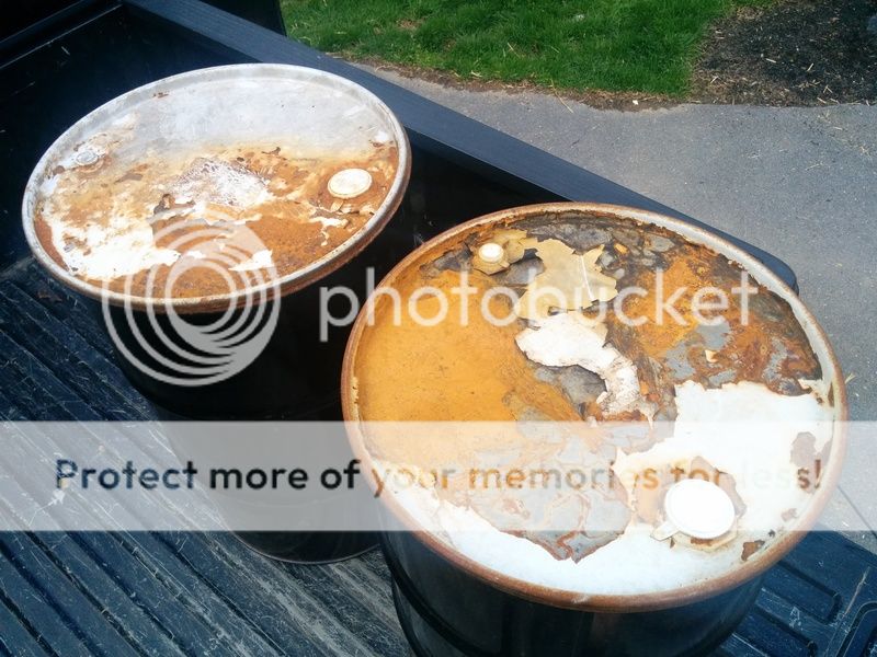

After the burn
A bit of a pain getting the rest of the liner out. Used a wire wheel attached to an angle grinder to get most of it out. Figured what was left after a burn that turned the barrel cherry red and grinding the crap out of was OK to stay. 3/4 of the way through liner removal.

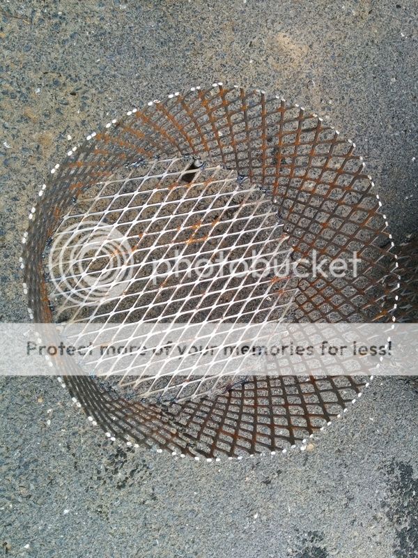

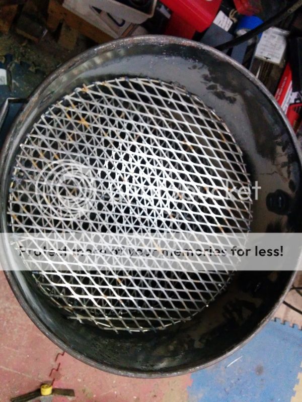

We used #9 3/4" expanded metal for our charcoal baskets and cooking grates. Each barrel has 2 cooking grates. One at 6" from the top and another at 12" from the top.
Charcoal basket. 15" diameter x 10" high. Will hold plenty of charcoal for a long cook.

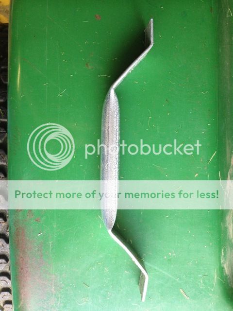

We used 1/2" electrical conduit for our handles.

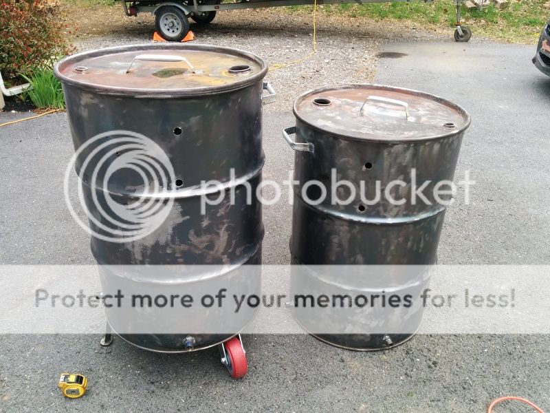

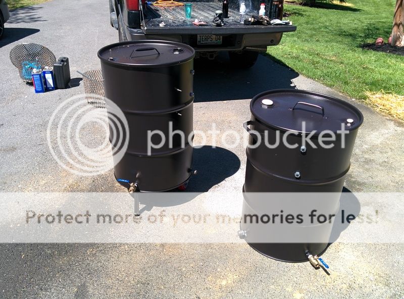

Being 6'8" I wanted my barrel a bit taller. Used 2 casters I had laying around my shed and a piece of angle iron as a front foot to raise my barrel about 7".

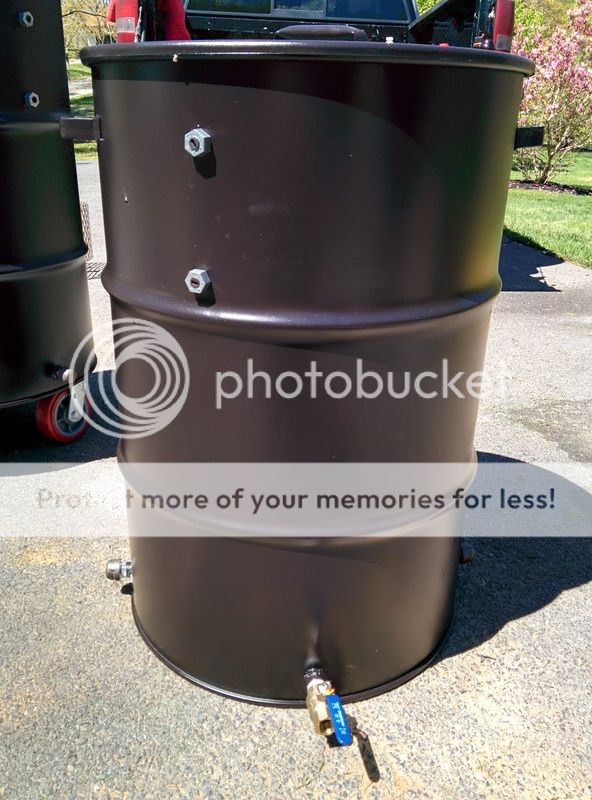

Prepped the barrels for paint by taking my wire wheel to the outside and then wiping down with denatured alcohol. Used Rust-Oleum high temp bbq paint through an HVLP spray gun.Turned out pretty nice, IMO.

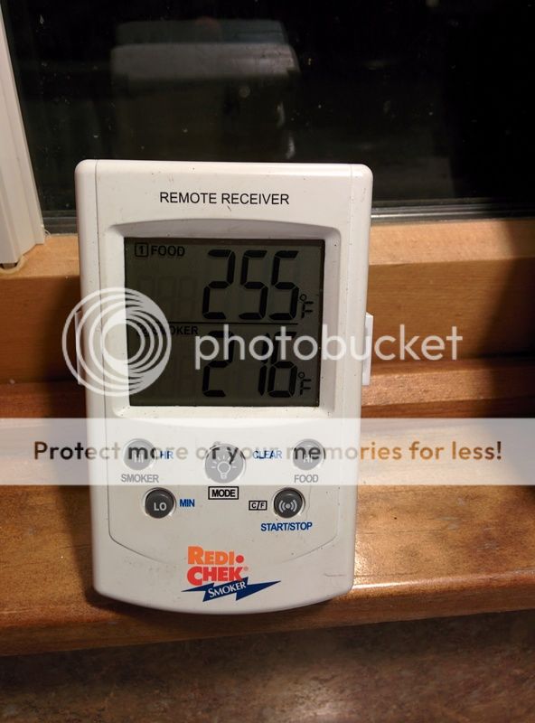

Seasoned mine with 1/2 a basket of lump charcoal and it held temperatures really well over about 8 hours. Huge improvement over my old offset. Hardly used any of the charcoal and I had less than a dust pan of ash in the bottom. Will probably fab up an ash tray to attach to my charcoal basket at some point to make cleanup easier. The UDS uses 3 - 3/4" pipe nipples on the bottoms for intakes. 2 are capped with pipe caps and the third has a ball valve attached for fine tuning your cooking temperature. Bottom grate is about 30-40 degrees warmer than the top grate. A homemade heat deflector make narrow the gap. This was at the 8 hour mark.

P.S. What are the 2 big nuts on the outside of the upper section?

Nice. Use a leaf blower to stoke the fire when burning out. That will get the fire hot enough to burn out any and everything inside the drums.

Those are waterproof conduit connectors. Basically a hollow nut with rubber inside and a small hole in the rubber. It's what we use to insert our thermometer probes into.

Oh yeah!! Had the leave blower out and the barrels got so hot they were glowing red. Was afraid they would end up warped when I was done. That liner is a PITA to get out!!
