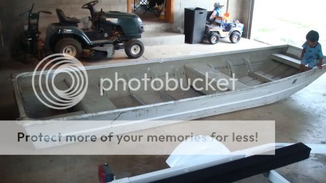

Thought I would get a thread started of my boat since I'm about to begin working on it. My trailer project is finally coming to an end with the exception of a few bolt on items I still need to purchase so its on to new things. This is a 1981 Lowe 1436. I bought it a few months ago on Craigslist. Hopefully get it stripped in the next few weeks and get the transon replaced so I can get it into a weld shop for a couple repairs. Heres a few pics of what I'm starting with. Oh, I called my thread Project Slab Assassin cause thats what I am leaning toward naming my boat when its complete unless I think of something really cool before I get done!!
My little man loves to play in the boat. Cant wait till its done next spring and he can come fishing with me!!

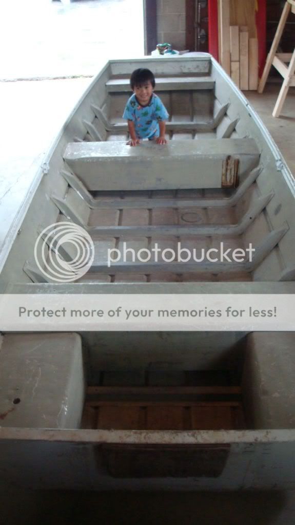

Heres a couple more pics. Can someone tell me the purpose of the wood on the back of the boat? Do I need to put that back on there when I replace the transom?

looks like a good boat to build i have a yazoo that is a 1438 and its extremely stable with a deck on it but im eventually gonna redo the whole thing i didnt plan my last deck and i hate it its too short and i tried to put rhino lining on plywood bad mistake the first time i took it out the lining peeled off. Name the boat "ss master baiter " i think that would be a good attention getting name. oh and airplane stripper and a pressure washer does good for stripping the paint. the plywood on the back serves no purpose except making the boat look tacky just leave it off

he's talking about the piece of plywood bassblaster has on the backside of his transom... where the motor attaches. look at the 5th pic in this thread to see what im talking about

arkansasnative wrote:he's talking about the piece of plywood bassblaster has on the backside of his transom
I'd definitely replace it, find a nice piece of oak, stain it a color of your choice and coat the piss out of it w/ polyurethane. Think it looks classy and timeless, a throwback to more simpler times, IMO.

Yeah.... the wood is a good idea to replace.... If it was useless and didn't protect your transom than why do some brand new jon's come off the show room floor with the wood in place? :wink:
As for using polyurathane....don't... instead coat the pi** out of it with spar urathane.

Thanks. I couldnt tell if it was something that came on the boat originally or if it had been added later. I'll be replacing it. So its basically just to stiffen up the transom a little more then, huh?
As far as treating it, I see tons of good reviews here for the spar urethane so thats what I had planned to use for the transom.

I think the plywood on the transom is to reinforce/stengthen it.

I replaced the plywood on the back because I feel it stiffens up the transom and protected the aluminum from the motor clamps. Mine is just treated with Thompsons, but I plan on painting it green to match the boat later on. The way it is bolted on, it can easily be replaced every few years if needed.
