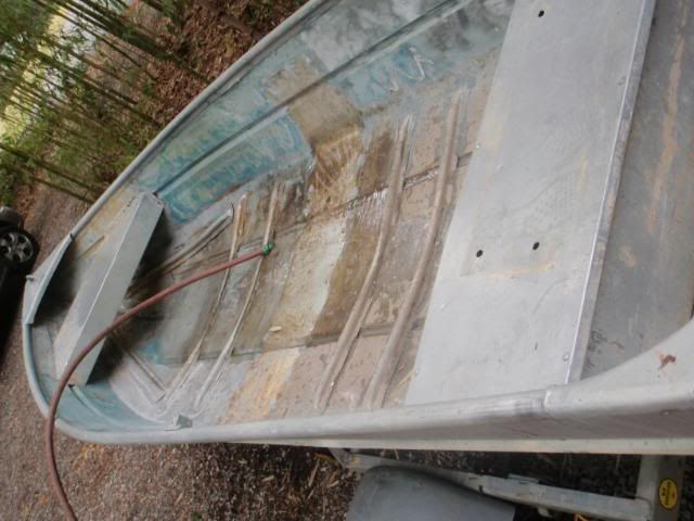

Started removing some paint, under the silver there is a gaudy teal color, vintage Whaler-esque.
Decided to take the middle out, I will brace properly and add foam elsewhere.

For tomorrow, my plan is to get the rest of the paint off the interior, redo the Bondo mess with aluminum epoxy, and replace the transom.

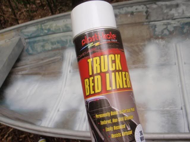

Had two cans of spray on bedliner I got awhile back to put on the Gheenoe but never did want to sacrifice the speed. Hit the inside with what I had, I'll pick up 3-4 more cans tomorrow I guess.

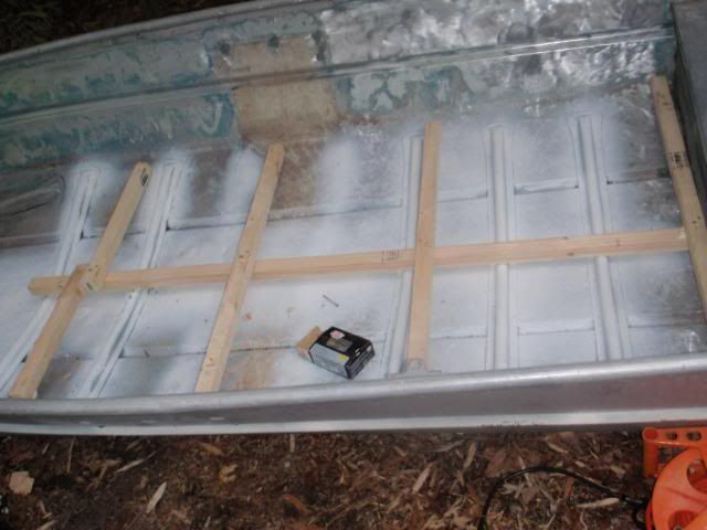

Started messing around with a stringer. The floor will be 4.5 inches off the floor at the V, 2.5 on the sides. I'm keeping it low and will be filling it with foam rather than trying to do any sort of storage.

Looking good. I didn't realize they made a white spray can bedliner. Look forward to your progress. How big are the strippers you usually catch?

Yeah, they have it at the Advance Auto by me. You can order it as well.
